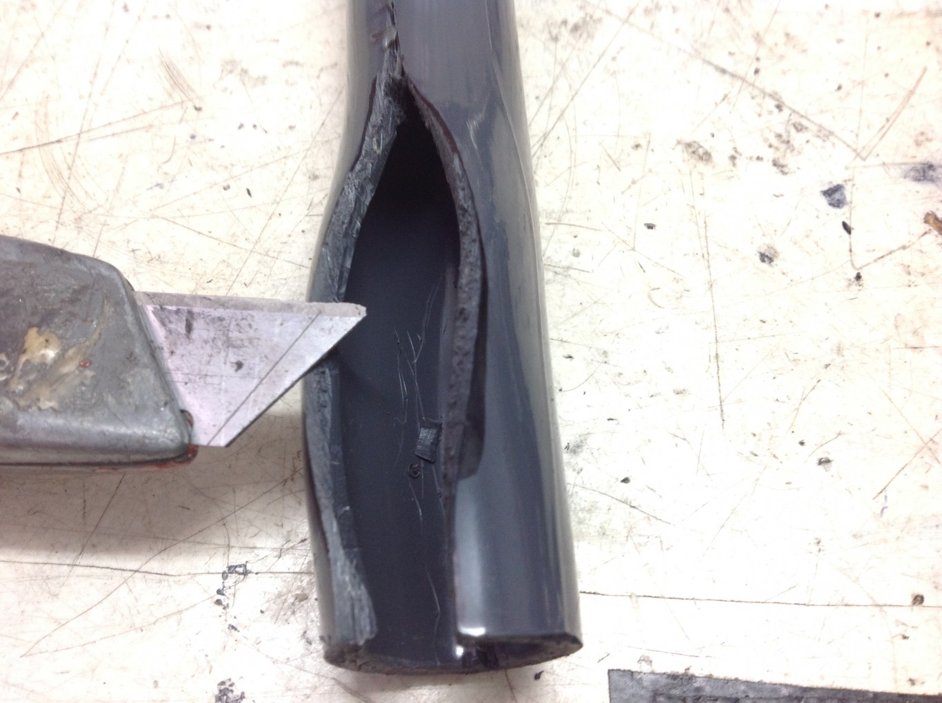

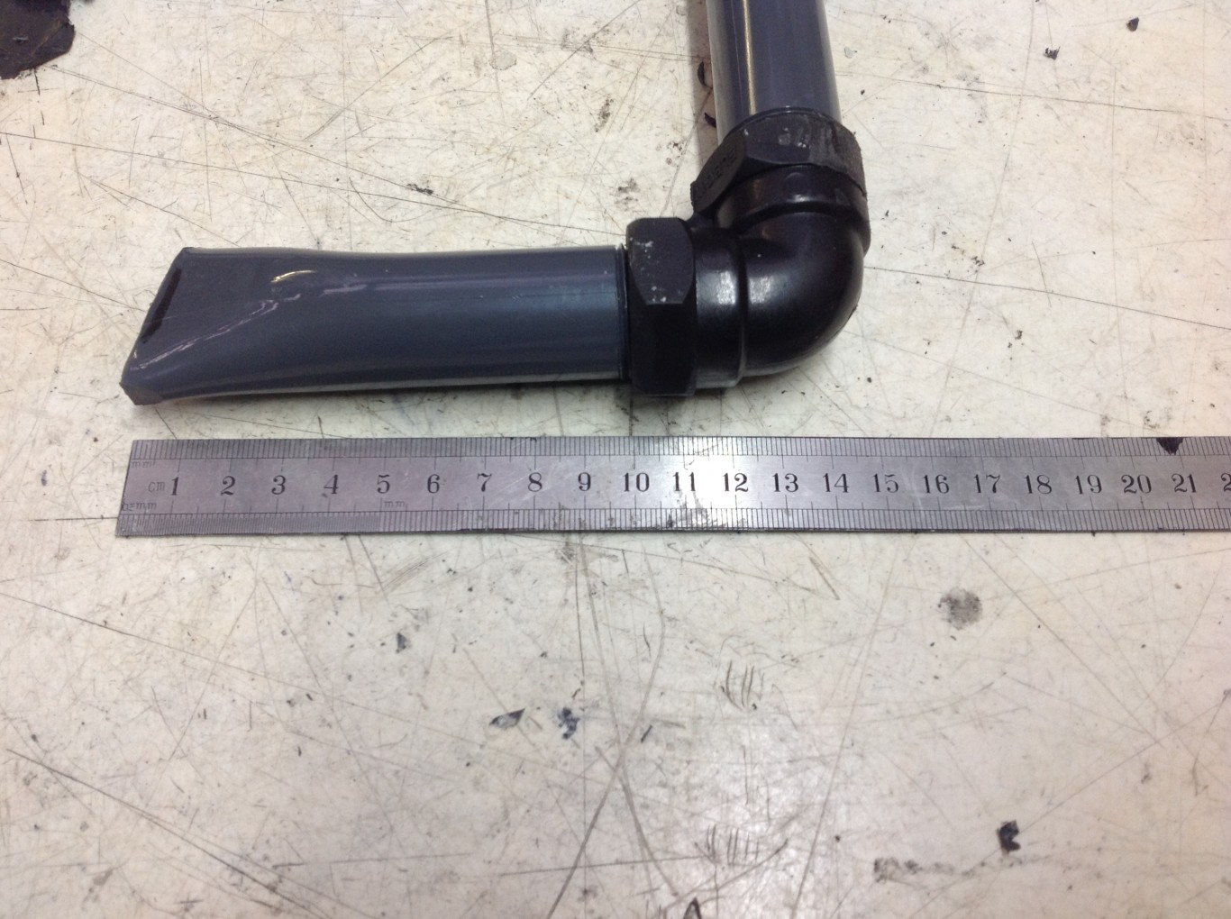

Now I'm going to make the second version and I think it's going to go like this
So let's make it again

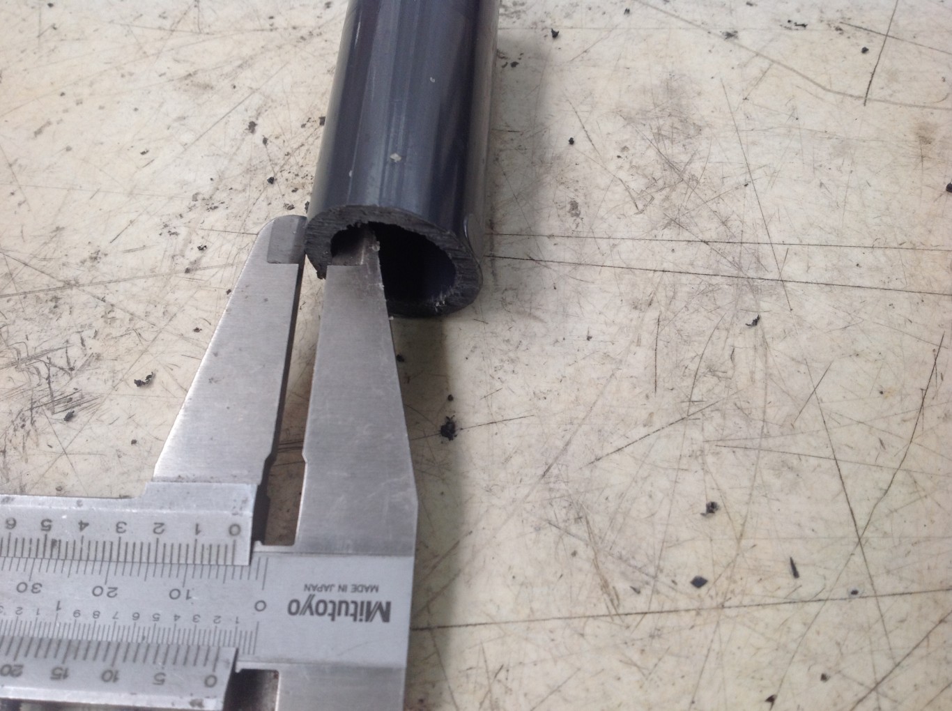

Some 300mm quality irrigation pipe
Screw it in cut off at 300 total 8cm slit up the middle
25mm diameter
4mm thick
Offline Tioli
  • Posts: 153
  • Town / City: Tasmania
Re: Tioli mods

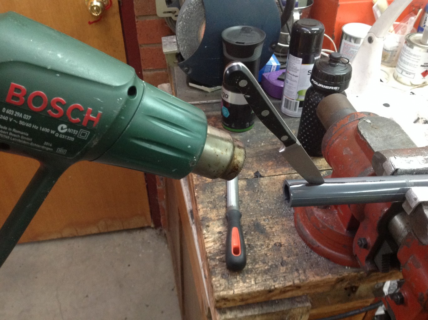

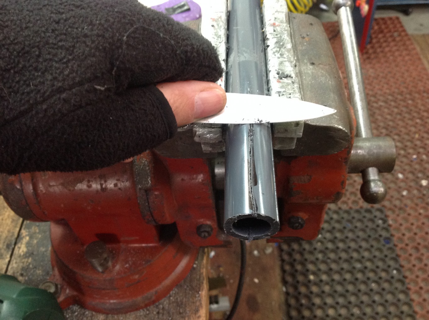

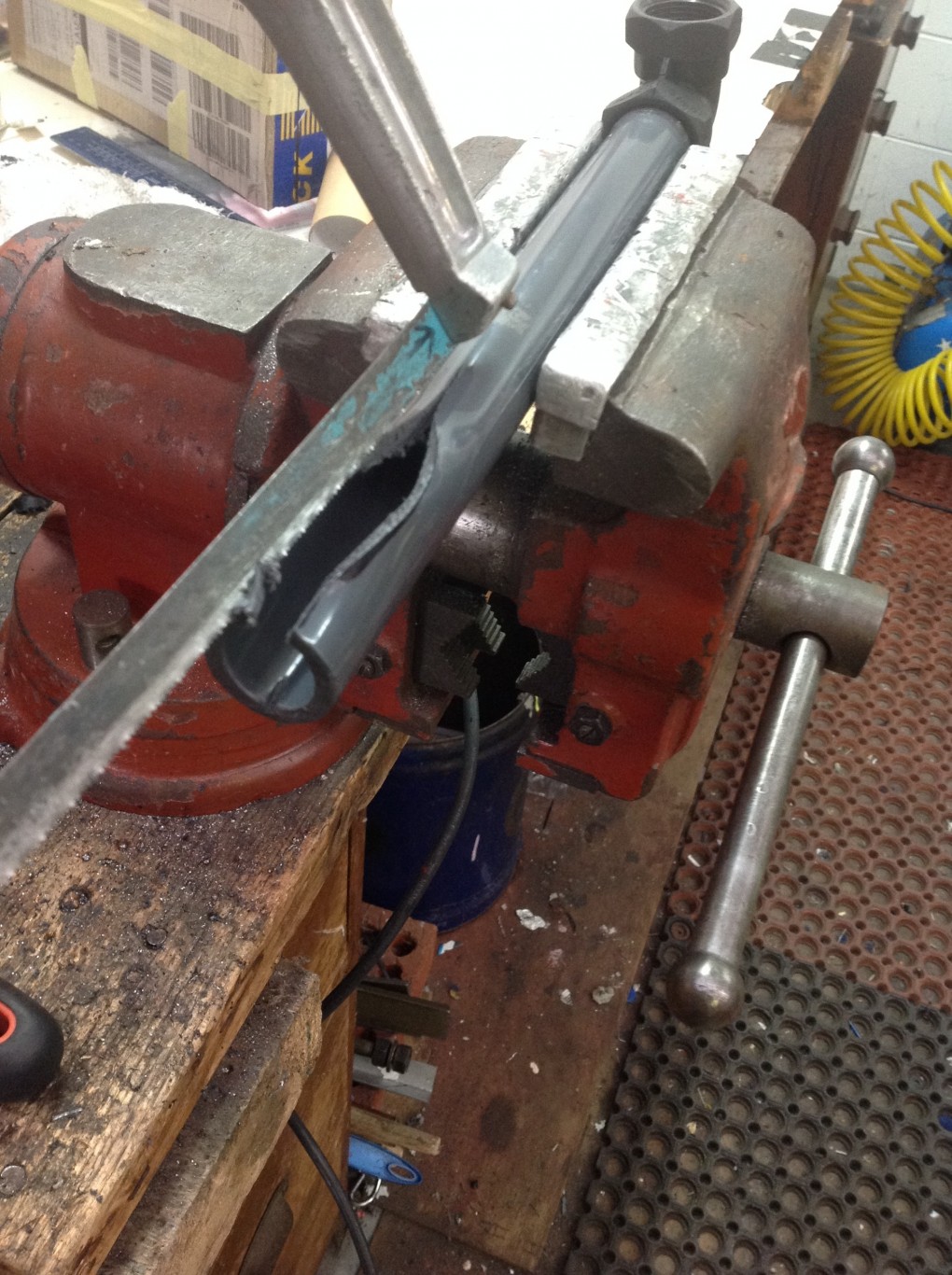

« Reply #86 on: June 19, 2020, 02:38:48 PM »
4mm thick
When you cut with a hacksaw clean up the shavings
Heat the pipe slowly up the length of the slit
Line it up put in place and hold that bulge in till it cools
Could do with a touch up, we'll see how we go
Trim and shape the ends to open it up so you cam snap it back on
I don't know if this is necessary but trim the sharp edges as its not about blighting in position but shape

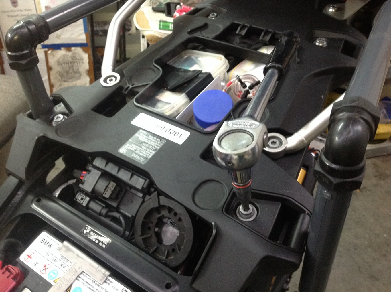

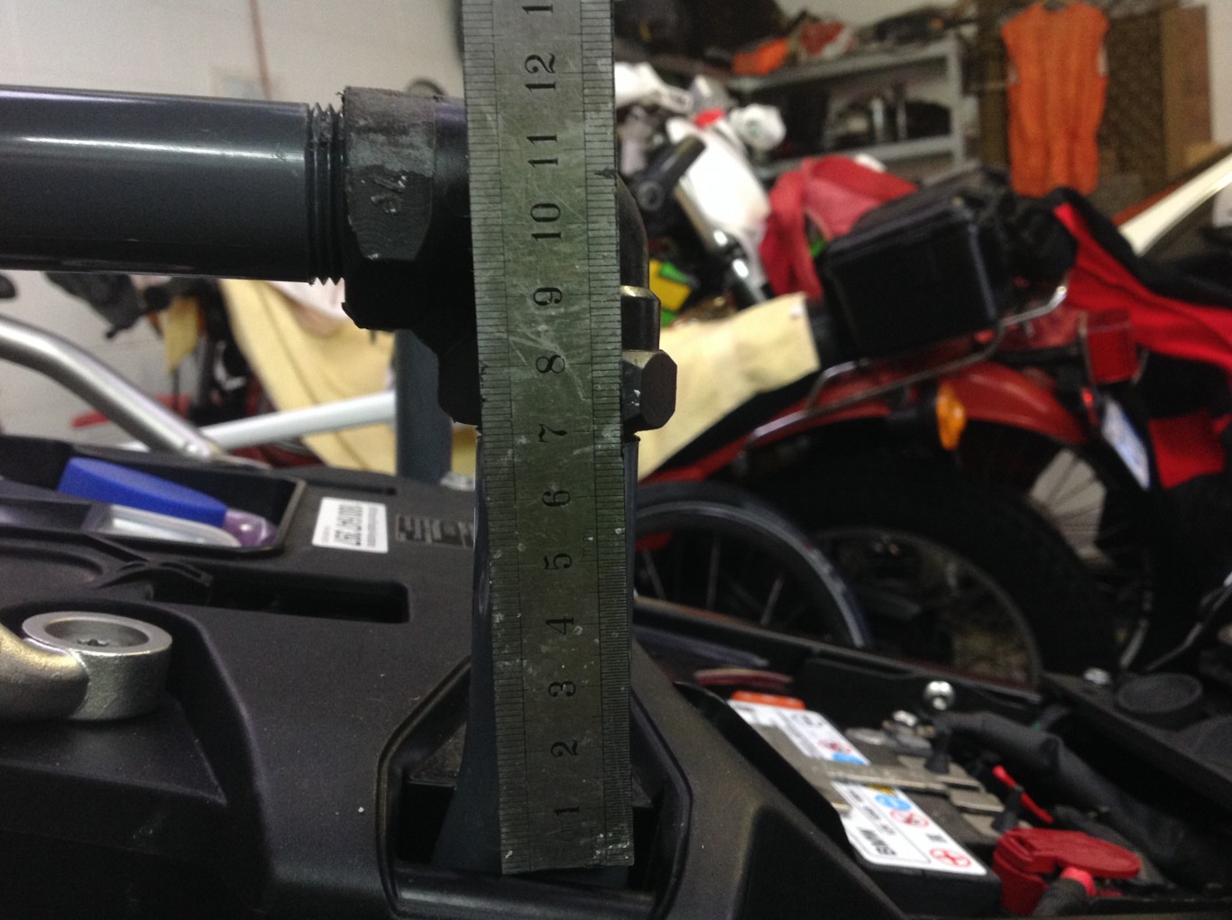

Take off the caps to the pannier mounts
Measure
Measure again
Check the angle, cut, heat, line up and jam it in that hole and hold steady till it sets.

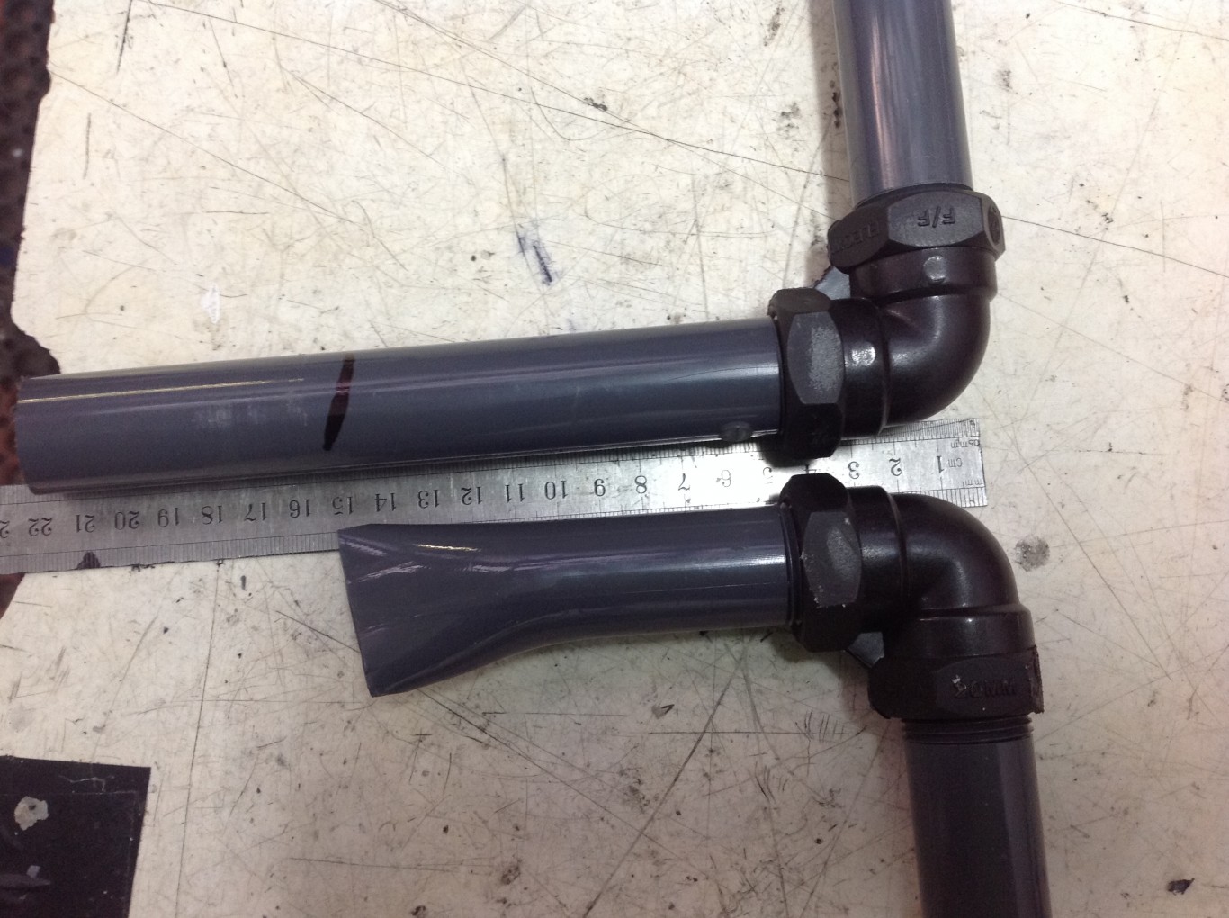

Offline Tioli
  • Posts: 153
Re: Tioli mods
« Reply #87 on: June 19, 2020, 03:10:24 PM »

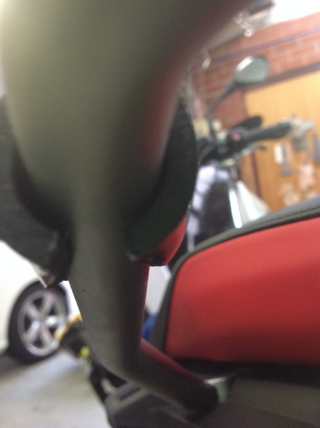

That is where it wants to sit. If you brush the back of your finger across the front end it will come out and roll over to the side. The back has no intention of letting go.
Down ward pleasure locks it in proportionately to the downward force. If you held it down and bent it sideways one of them is going to breake  and that pipe is strong.
Again I don't know if necessary but dress a bit
Round off where the bag goes round
That round edge will hold the bag in that corner and downward force across the top will be shared at 3 points evenly

« Reply #88 on: June 19, 2020, 03:25:48 PM »
Sits squair
Big enough gap between pipe and bag
All up bags and rack $300
The bags are made of that type of bubberised plastic. If I hold it some tape both sides and it's fixed.
That's a 5L container 5 are supposed to fit in the pannia if I put 25kg in the bag how would it be supported?
At the top fine but the bottom would have to much sideways movement for a lot of weight so I have some plans to fix that.
All the straps are in the right place
