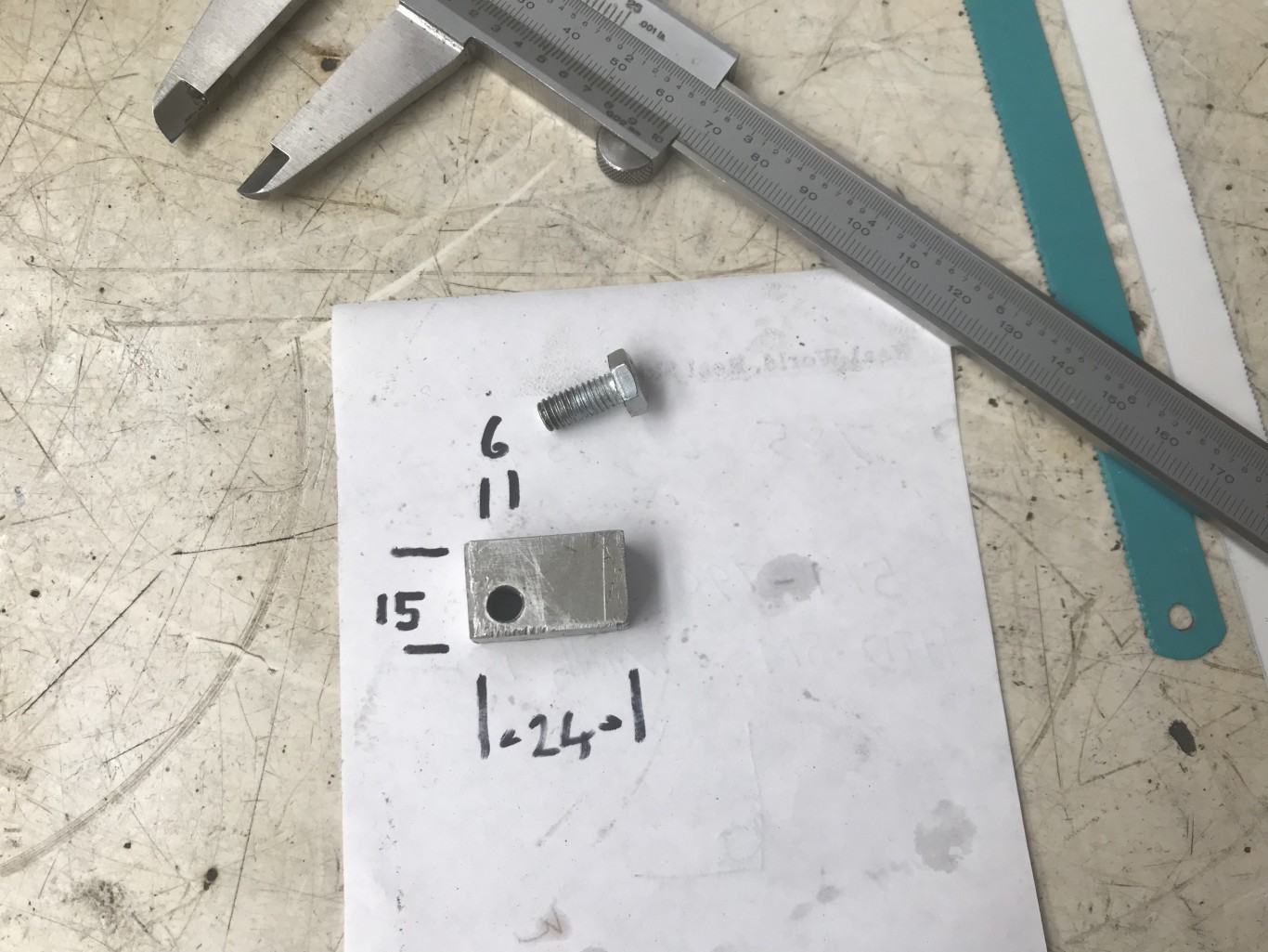

    Dug out a block of aluminium 1cm thick then drilled and tapped a 6mm hole in one corner.

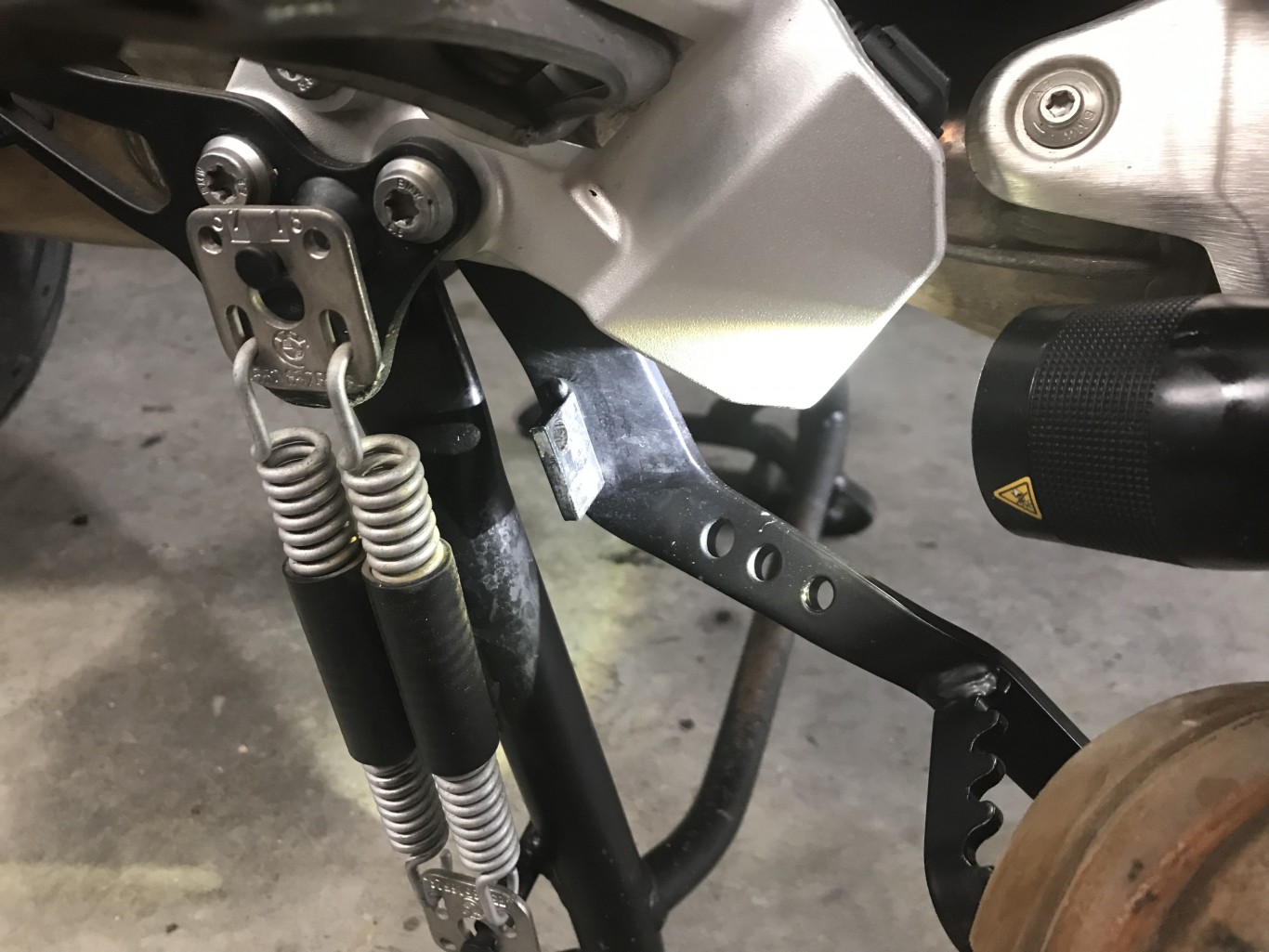

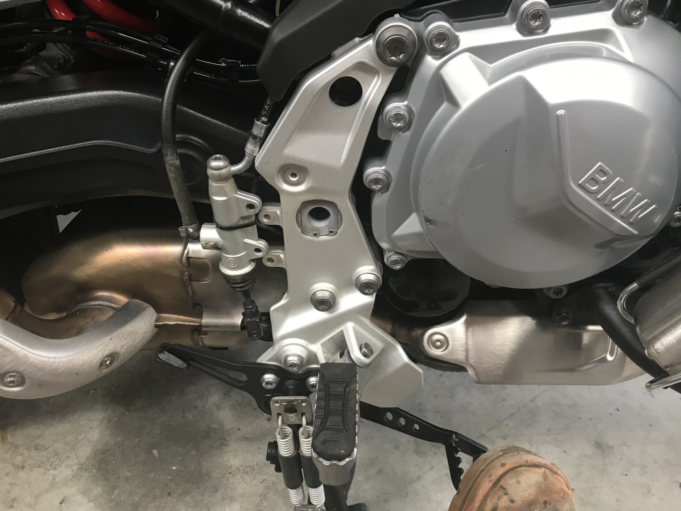

    Took the heal cover off the master cylinder. Notice how you can press the brake down further and the master cylinder can move up.
    Thatís the spot where the block goes. The plate is there to activate the micro switch for the brake light and act as a stop  but I wouldnít need to be that big or have the hole in it if thatís all it needed to do. So it has another purpose and what Iím doing may be it.

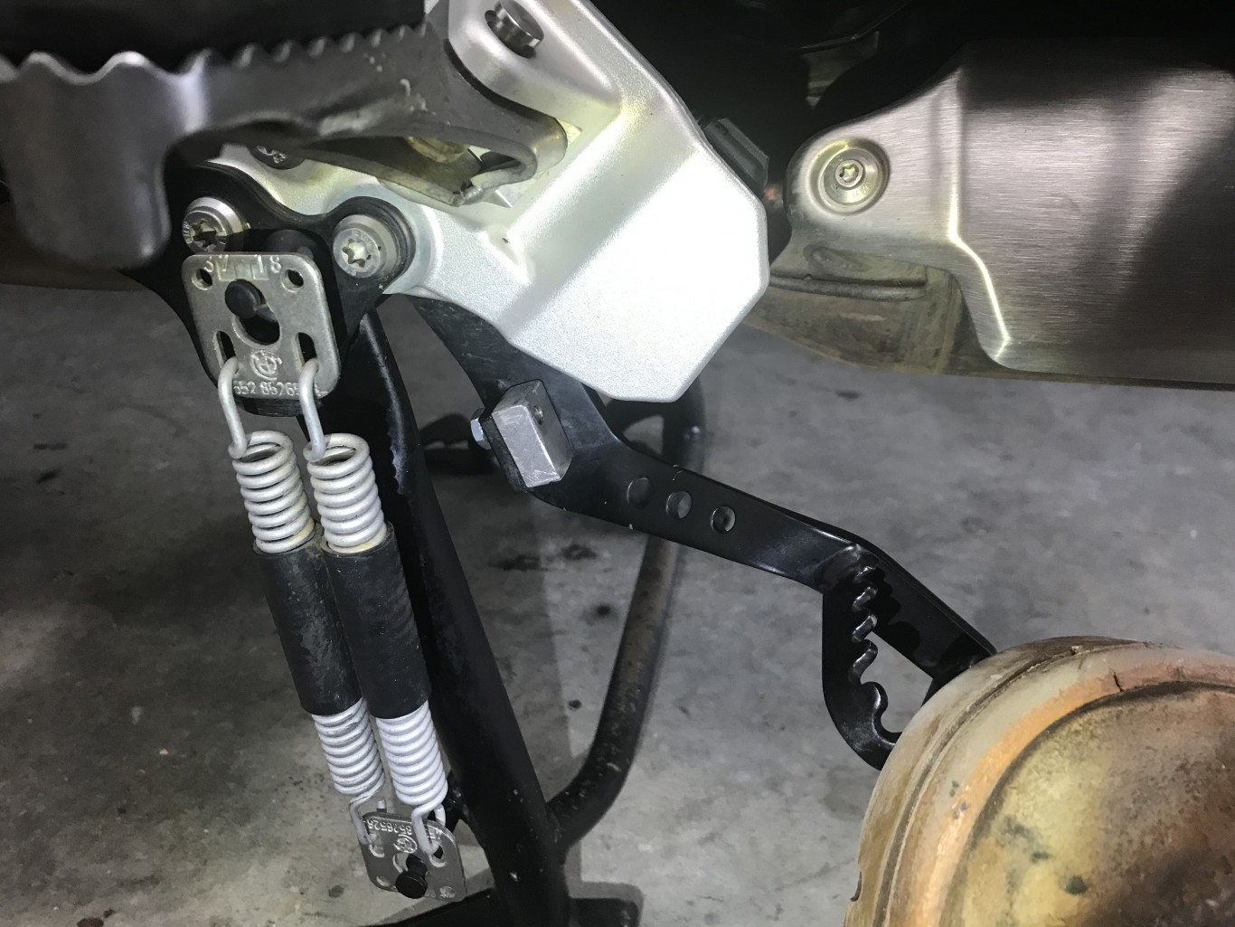

    The block goes on like this
    Normal height with out the block
    With the block

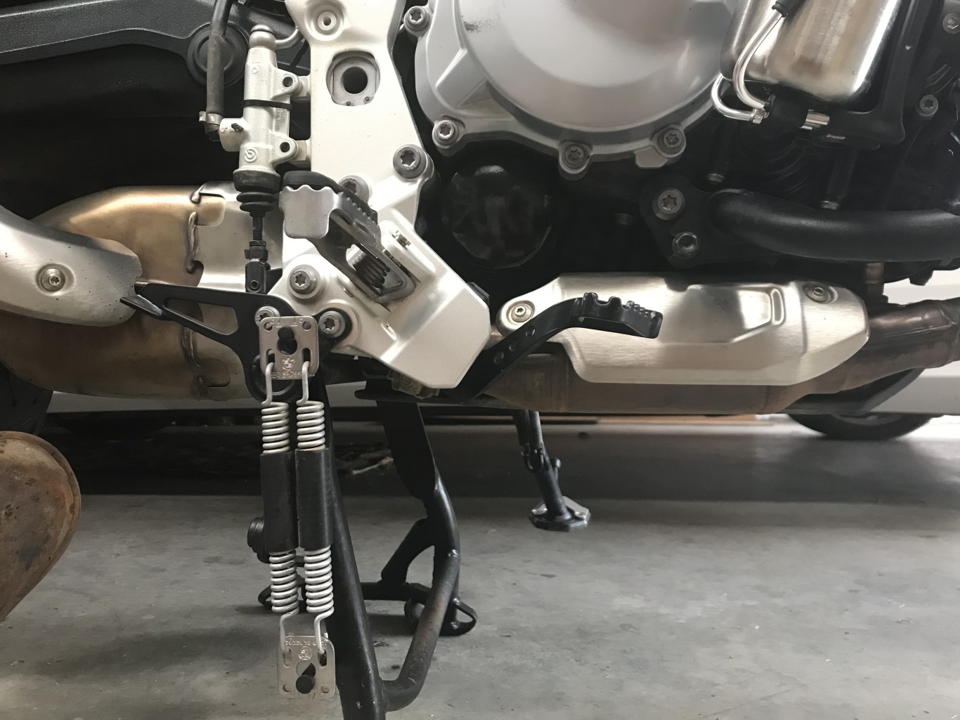

    The next thing is to readjust the master cylinder as lowering the foot brake will lift the master cylinder up and the bolts wonít align.
    Undo the adjuster nut and turn it in to lower the cylinder
    When it comes down enough by screwing it in the cylinder will realign the bolt holes
    Then lock it off in the new position
    I used a straight edge to check whatís going to happen if I leant the bike over enough to scrape the foot pegs and itís reasonable
    I have had it out on a few rides now an the first time it was noticeably different but after that the issue I used to have disappeared. If I were to do it again possibly a 7mm thick block would still work but itís working so I will just leave it
