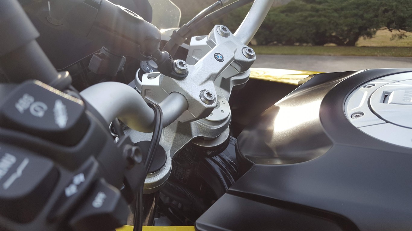

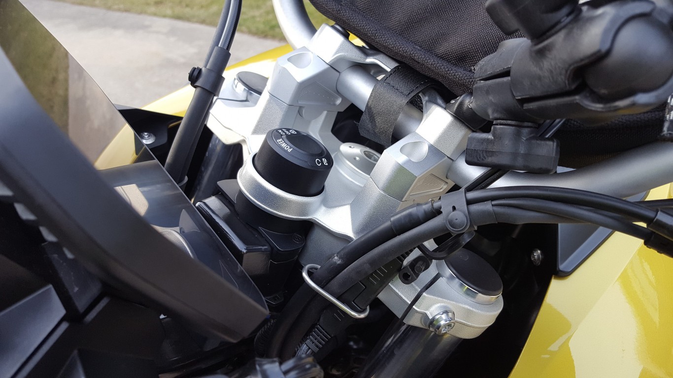

Hi Guys,
I bought these bar back risers on Amazon for $26
https://www.amazon.com/gp/product/B07X4TWKZ5/
... similar items are available on eBay for $15.  These risers move the handlebar up 23mm and back 20mm.  Low prices scare me, they raise all kinds of questions concerning the quality of the materials and manufacturing tolerances.  That said, the seller claims that these $26 risers are made of CNC 6061-T6 Aluminum Alloy which, if my limited knowledge of metallurgy is correct, is an appropriate material for the job.  The four hex bolts that came with the risers appeared to be of good quality.
I shopped for better quality riser that would move the handlebar rearward but there were none available from the usual suspects (Wunderlich, Hornig, SW Motech, and Touratech).  I did find some barback riser by ROX but they only fit the F850GS, not my F750GS (different diameter handlebar?)
So, throwing caution to the wind, I mounded up my new $26 risers.  They installed very easily and, function-wise, they fit perfectly.  Cosmetically there are a few errors in the casting, the edges don't line up exactly with the edges of the factory mounting or with the factory bridge but overall, not bad.  There was no binding or pulling on any of the wiring, cables, or hoses and the only adjustments I had to make were to the mirror/clutch lever/brake lever angles.  I gave the new setup an 80 mile test ride today and I was very pleased with the new handlebar position, it is surprising that the 20mm back would make as much difference as it did.  Looks like a winner!  :062:
What do think?  Too cheap to be safe or good to go? :034:
RI Mark F750GS

Hi Gazza750, thanks for your input on the issue.  I agree with you, I too would rather buy a proven brand but none of the recognized provider sell bar back risers of this design.  Maybe that is the problem, maybe the design itself is questionable.  That said, a fellow club member that I run into once in a while at the local BMW shop has had these cheapo riser on his R1200RS for a few years and he has had no problem with them.  Since I installed the risers I've ridden a several hundred miles with no issues, no flex, no movement, no readjustments, just glorious comfort.  Would I rather that they cost several times as much and came from Touratech or Wunderlich, you bet, and when one of the recognized vendors produce a similar bar back riser I'll probably replace these but until then, these seem plenty sturdy and I am not concerned with their structural integrity.
Again, thanks for sharing your thoughts on this. :169:
RI Mark F750GS

There wouldn't be much of an issue scribing and filing the casting mistake to match the upper clamp...
