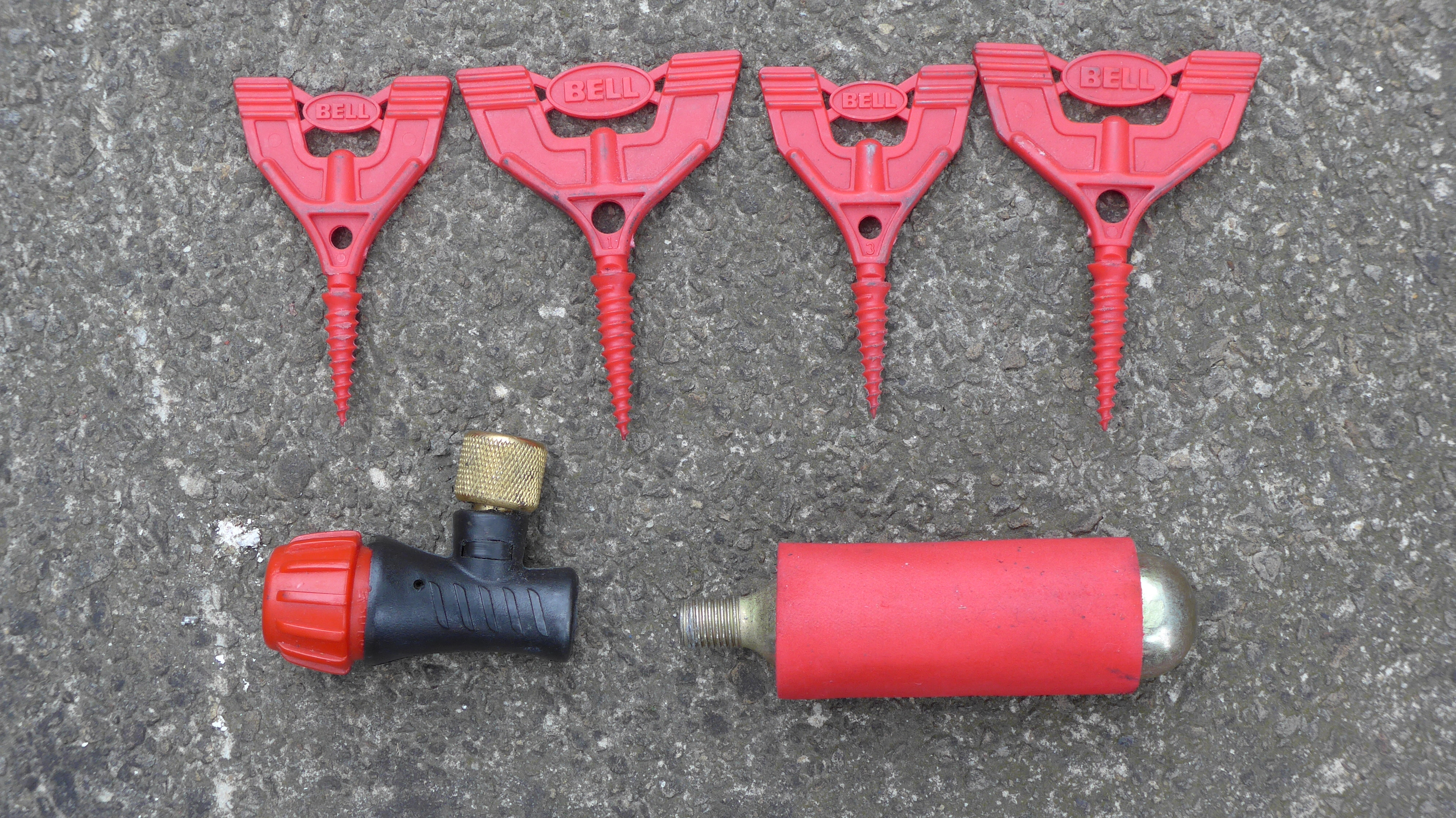

I have tried various plugging kits with limited success. The one I find best and almost fool proof is  made by Bell and was available from Halfords.
Select the right size screw to fit the Puncture, screw it into the tyre until the bobble on the end enters the tyre, snap off the handle, re inflate and ride cautiously until the tyre is swapped or a permanent repair is done. Works very well. Before I found this kit I used to use posidrive decking screws.

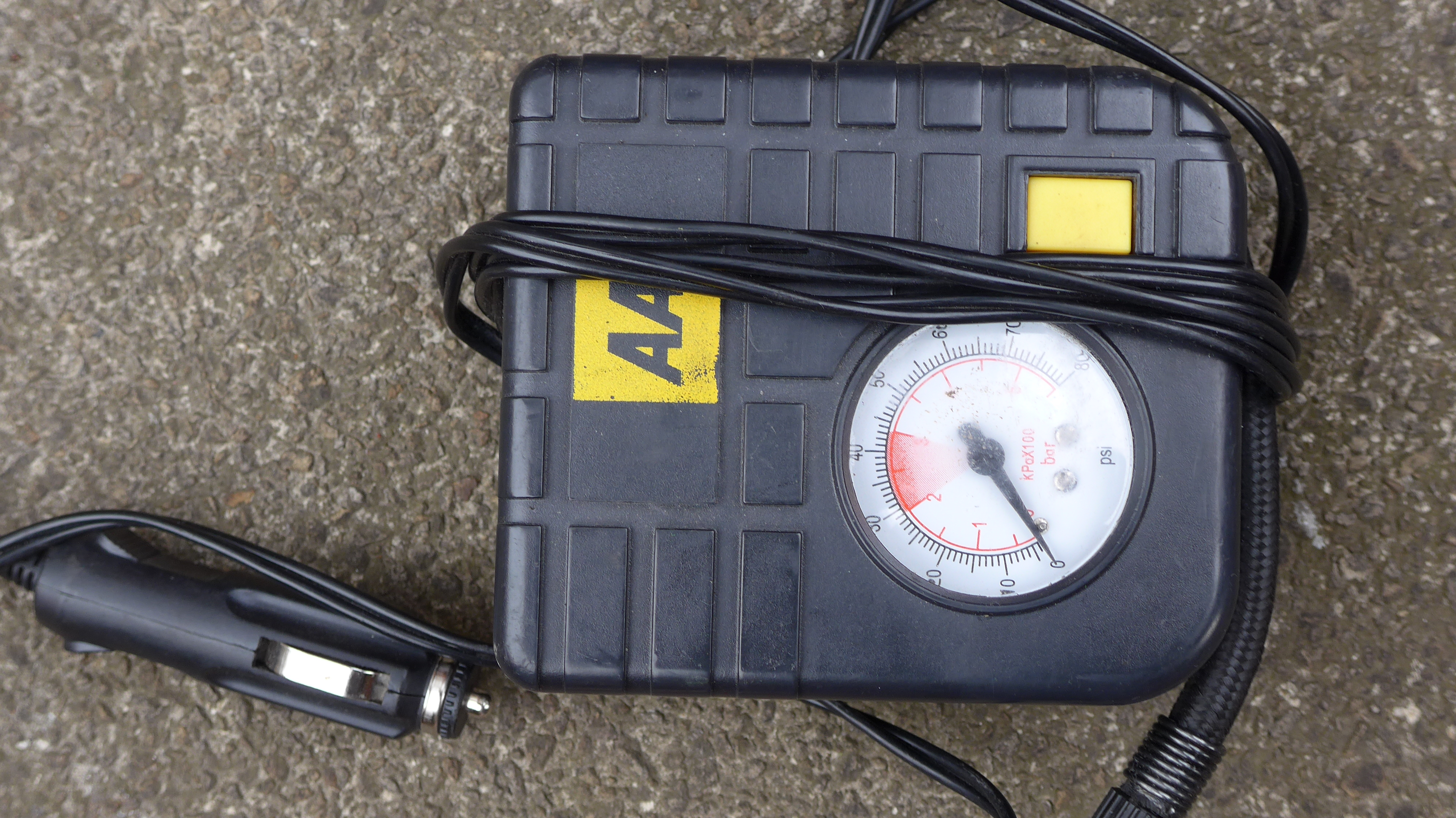

The little compressor was only a fiver from a petrol station. It inflates to over 40psi but takes some time. My GS800 standard accessory  socket trips out so I added a lighter socket connected to the battery via a fuse.

I have a mini compressor like that but the socket on the 850 only takes a din plug.  How will that work? Can I get an adaptor or will Ihave to wire in a 12v socket directly to the battery if possible?

snakenrose: "I have a mini compressor like that but the socket on the 850 only takes a din plug.  How will that work? Can I get an adaptor or will I have to wire in a 12v socket directly to the battery if possible?"
Get a "pigtail" ie SAE plug to eyelets. You fasten the eyelets to the terminals of you battery and leave the SAE plug peeking out below your saddle. That is where you plug in your tyre inflator.

PS. Make sure you have an appropriate fuse. I blew the 5 Amp fuse which came with my pigtail which for a few seconds had me thinking my pump was kaput. Nope, fuse blown to smithereens because Ye olde Slime draws up to 10  amps.  Inserted a 10 amp fuse and all is well. And carry a spare fuse just in case!
