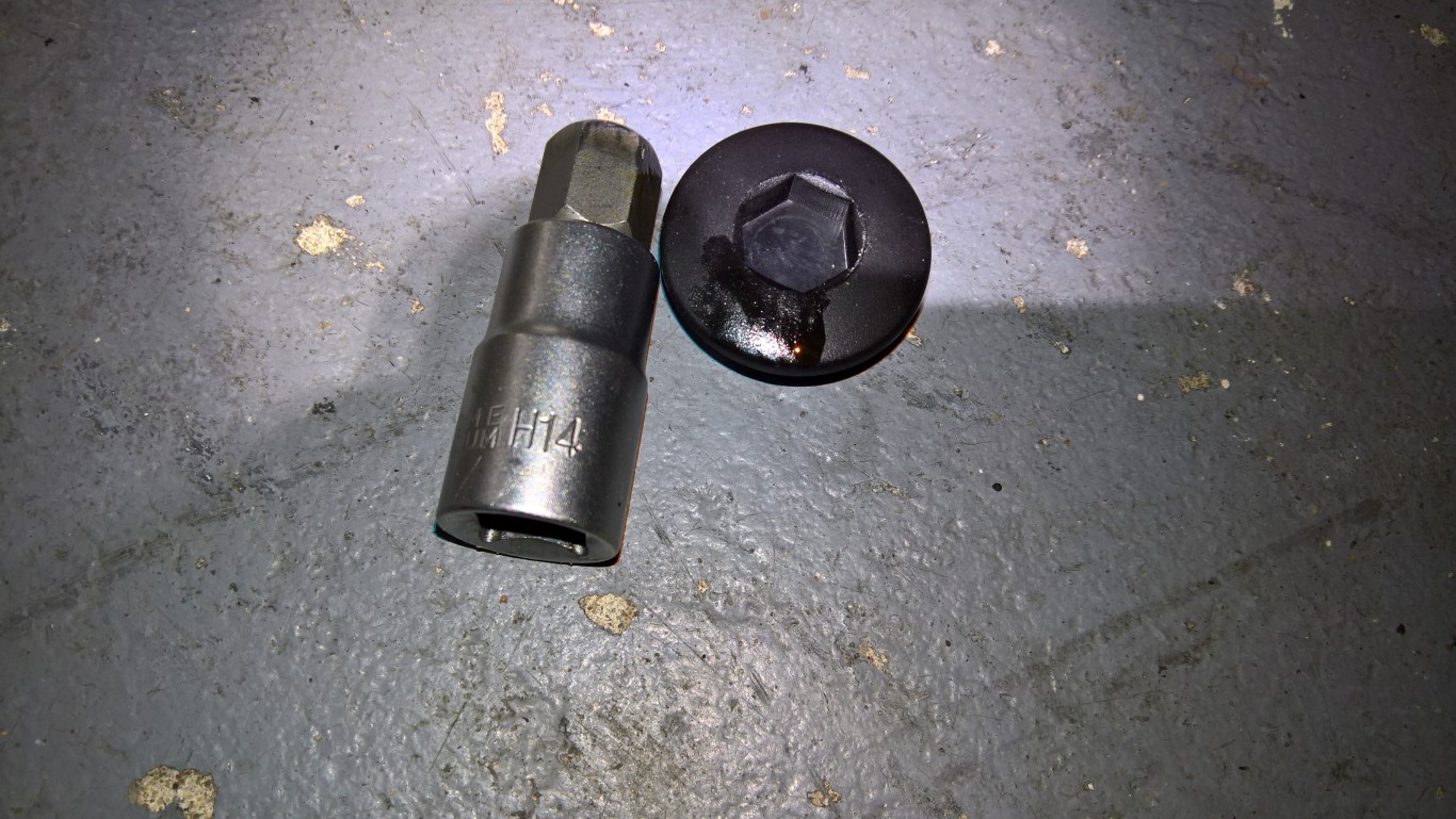

Here are the tools you need.
1. spark plug spanner 14mm (I only had 16mm)
2. hex key H14
3. torx T60
4. feeler gauge

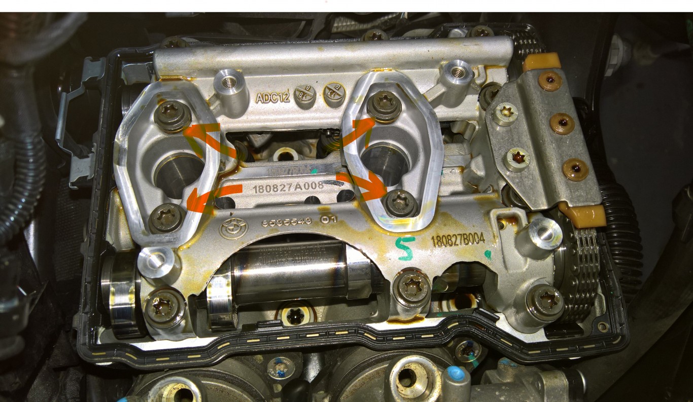

After unscrewing the cap, you can check the valve clearance. Checking is really easy.
Be careful, the 4 screws with arrows have washers that can fall into the spark plug hole  (This is important when removing the camshafts).

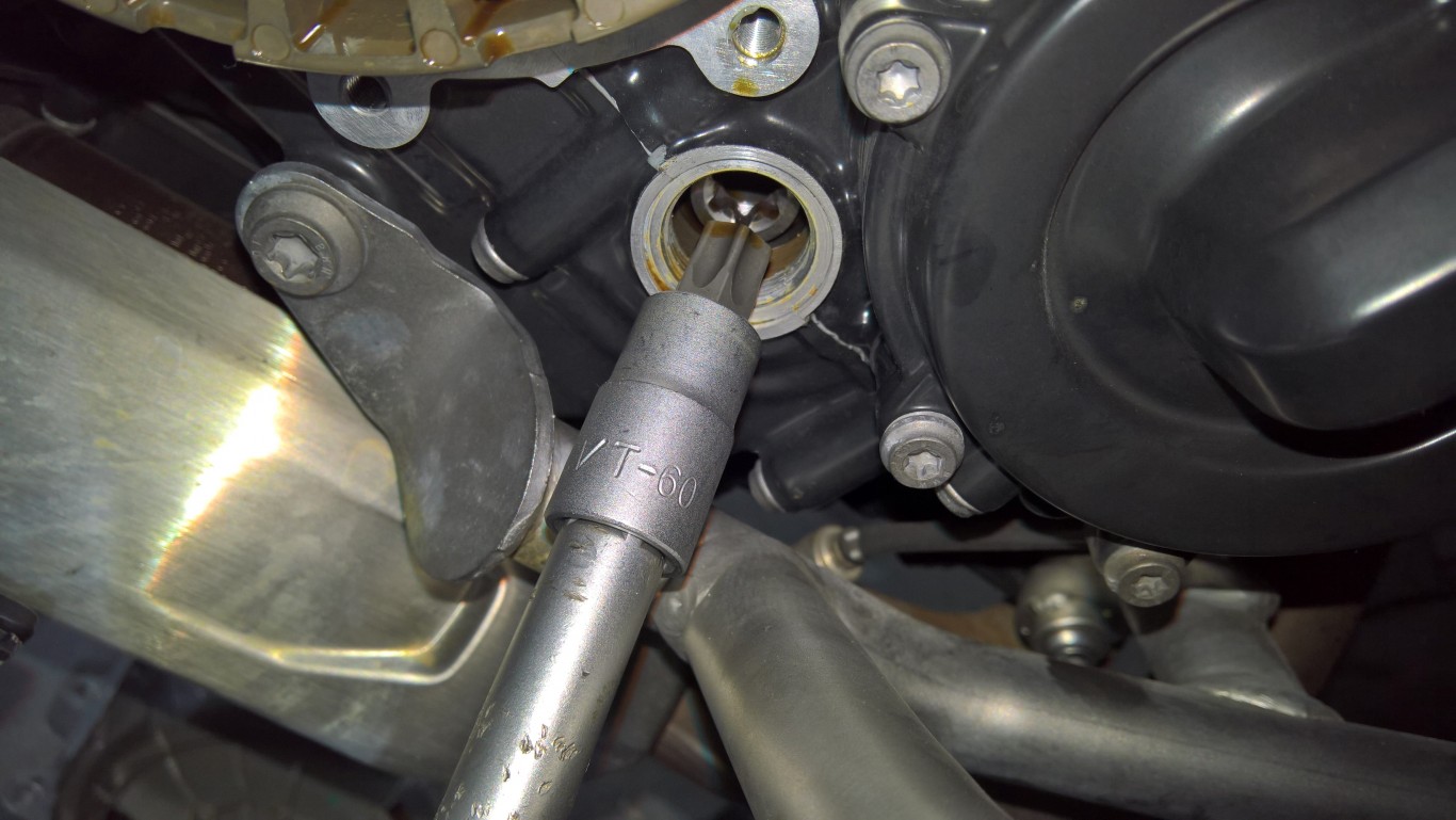

To get the crankshaft in the right position, we have to turn it.
To do this, the plastic plug Hex key H14 must be unscrewed so that we can
turn the crankshaft with the Torx T60.

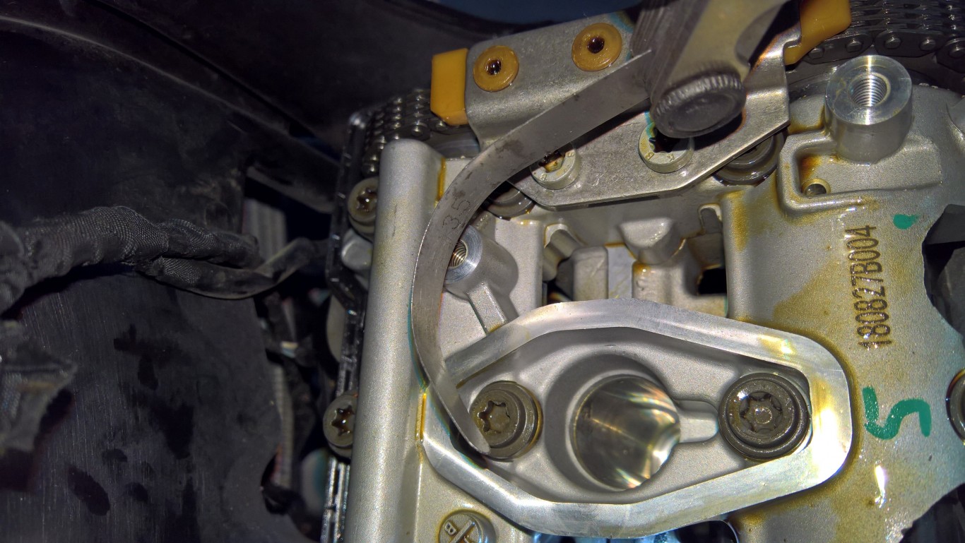

You have to bend the feeler gauge a little bit.

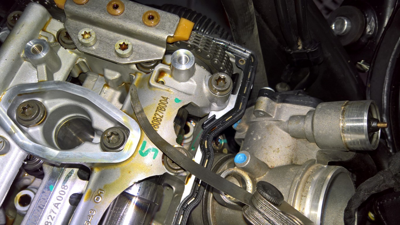

I checked the inlet valves first

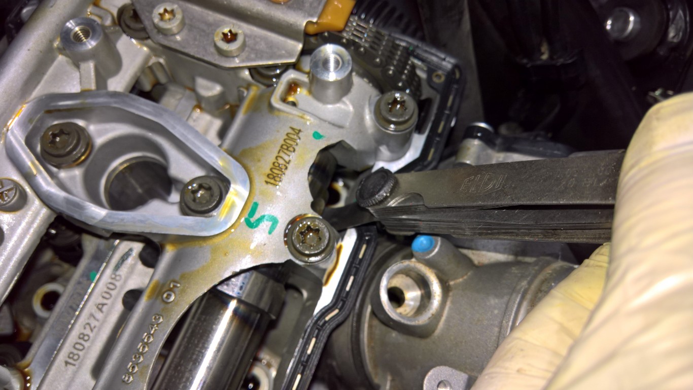

For the exhaust valves you have to bend the feeler gauge even more.
Now you can check the exhaust valves
